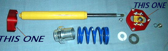

Hey guys when the car is lowered is it necessary that we install both the items i show in the picture? If yes or no please explain and name these items please... Worship

Alimonos; On the left you have an RCA(Roll center adjusters) and on the right you have a camber plate.
Both are from Technotoytuning.com.
You can read about RCA's here:
http://technotoytuning.com/t3_site_pages/faq/index.html#RCA
And about camber plates here:
http://technotoytuning.com/t3_site_pages/produc...amber_plates.html
I'm gonna go with a simular setup except for this beauties:
http://technotoytuning.com/t3_site_pages/produc...ont_coilover.html

Widar the RCAs are used only with adjustable coilovers right? Blonde question
Nope, they should be used with any extensive lowering to get the lower control arms to their right position.

Thanks a lot widar i 've found the answers in the T3 site... Worship
