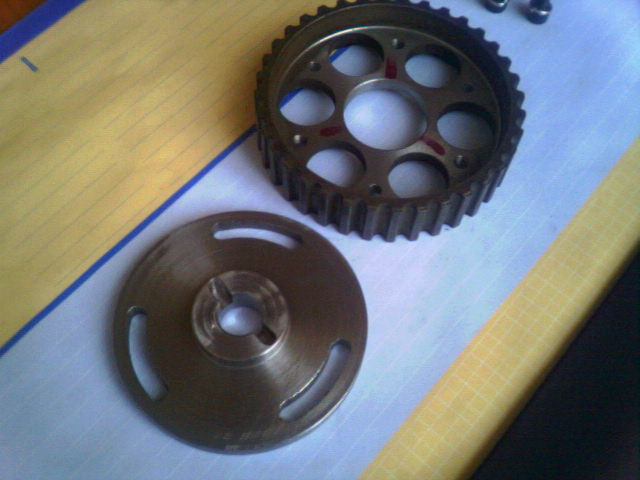

2 ZaX:
I asked becouse in your design of pulleys I cannot see how you will make offset between pin marks (holes) in the center and teeth part of the pulley (when lies the timing belt).

PostPosted: Fri Jan 07, 2005 2:55 pm    Post subject: Reply with quote
jamiemirror wrote:
2 ZaX:
OK, here's the pic off dissasembled cam pulley.

2 ZaX: Many thanks ! I have a spare set of timing wheels and just wonder how to make them adjustable easier way Smile
