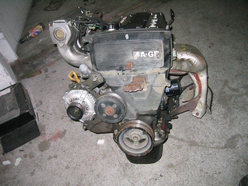

The smallport engine going into the car. This will get some smaller modifications before it's mounted though. Wink
Viewed 95 Time(s)
Redtop 140ps
Redtop 140ps
Viewed 88 Time(s)
Redtop 140ps pic2
Redtop 140ps pic2
Viewed 84 Time(s)
Old unknown spec TRD cams that I plan to try. From the lobes they look like at least 272 i think? (lift about 7.5-8mm)

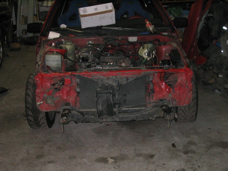

PostPosted: Mon Nov 06, 2006 8:24 pm    Post subject: Reply with quote
Had a "little" accident with my MR2 right about the time I was starting on this project, causing me a bit of a delay (and a huge hole in my pocket...) Confused

So now finally its back to the Hathi fun Wave
Update sofar is this: the ugly rust holes has now magically disapeared. Cheerleader
Engine is also almost ready to go in. A local engine guru has been helpful with a full overhaul. What has been done sofar is:
honing and new piston rings
balancing and weight adjusting of pistons, and rods
balancing of crank, flywheel and pressure plate
ARP rod, main, head and flywheel
TRD 0.8mm headgasket
King rod and main bearings
head porting including valve job
shimless bucket conversion
shimming of block and head for increased compression
the old TRD cams in earlier pic installed (if the measurements add up they are 288in/272ex)
T3 cam gears
OS Giken 3.6kg flywheel
T3 ITB adapter and trumpets
I am inclined to use the blacktop ITB's instead of the more usual silvertop ones, but not 100% decided yet..
Oh, and the plan is to run this by a Megasquirt when everything is ready. Smile

Mux213 wrote:
Auch! how did you manage to do that?!?Sad

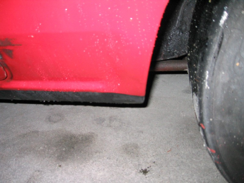

Actually it was all too easy and quite scary.. (not to mention embarrasing) Stupid
long drive, tired driver... Didn't pay proper attention for a few seconds and suddenly it was too late to break for a turn (wasn't even going fast). The choice between hitting a wall of stone or aiming for the grass was easy, however once on the grass the car just went along at almost the same speed regardless of my inputs. Then we tipped downhill not knowing what was on the other side... (this happend on a montain pass with *really* steep hills). I had never thought I ever would be glad to hit a tree Puh
