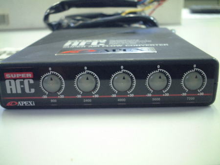

PostPosted: Sat Apr 09, 2005 11:09 am    Post subject: Reply with quote
I getting one of the older ones with the dials rather than the poser blue one. It allows me to boost fuel quantaties upto + 30% at certain rev ranges. I guess that ultimately the fule pressure will not be enough or the injectors too small, but i'm only looking for upto 150bhp anyway, not interested in getting an aftermarket ecu [too expensive]. It just piggy backs onto the standard ecu, you can download an english instrution manual from the web for it. The S-AFC is apexi rather than TRD btw.

What you are saying is that you can have around 150bhp from the stock engine with one of these? How much for them u said?

Apexi ® Super S-AFC-2 Fits all Subaru/Nissan/ Toyota/Mazda Applications
[1236-2KR] - $339.00 Free Shipping!
but this is gen 2! (the blue one).
was unable to find info about the gen 1.
_________________

is it a "plug and play" device Crimson and how much more power you gain? pics?

the S-AFCII is a piggy back air flow converter...basically it uses a 2d map to alter the air sensor voltage to decrease or increase the amount of injector pulse at a given rpm.
i am not sure what amount of hp u gain, but u can manage it to give more or less power at user-definable rpm's (eight-point's fuel curve set in 500 RPM increments)

You won't get any real power increase just using the fuel computer, the power increase comes from the 264/256 cams and adjustable cam gears i have. The fuel computer is there to get the fuelling right for them.
The 150 bhp comes from Bill Sherwoods site using the stock ecu.
