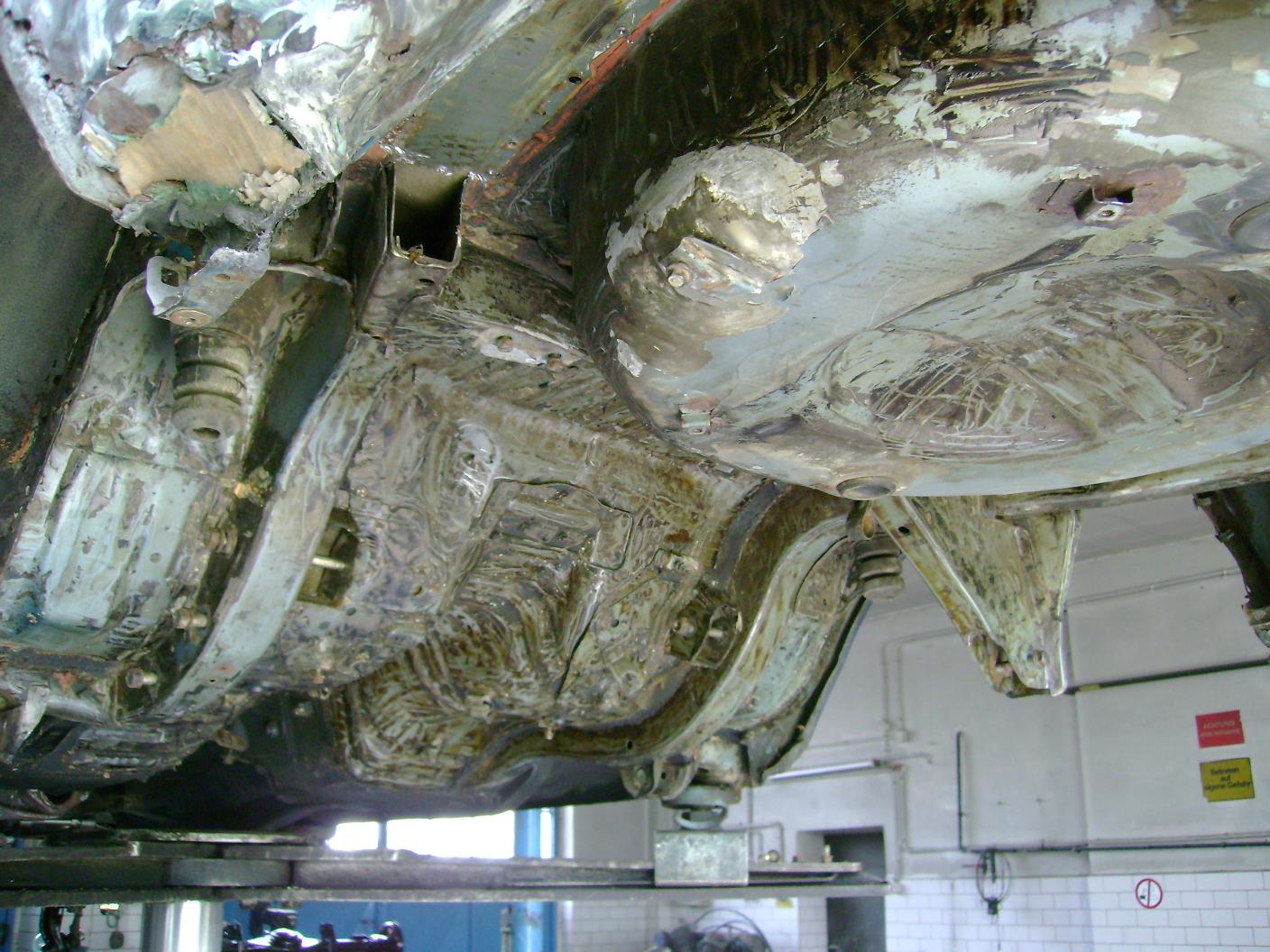

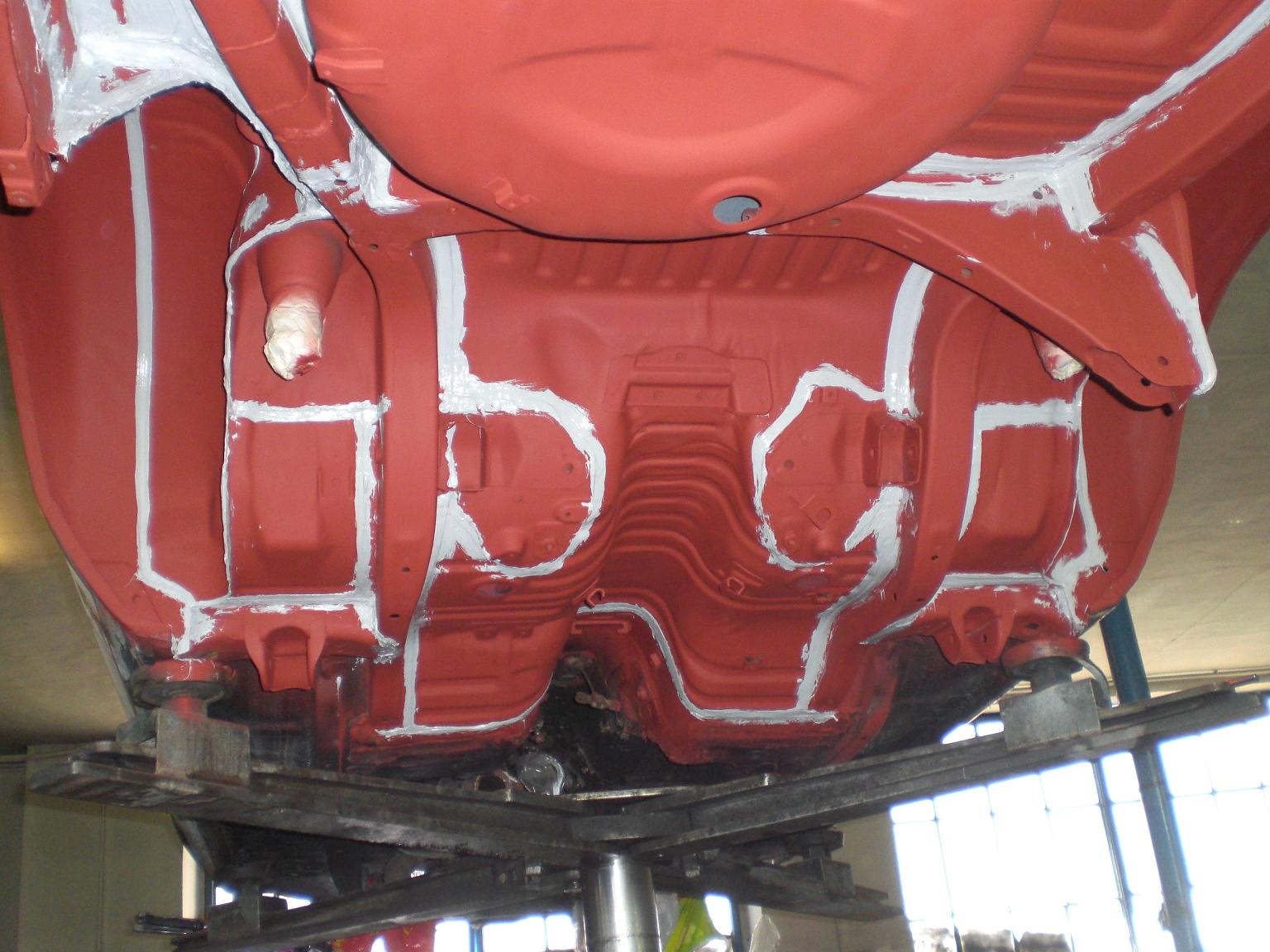

Hello,
after 1 1/2 year my Project is soon finished, here is what i did: Pic.1,2,3 this is how i bought it, 3 pre-owners, 160000 km Pic. 4,5 after strip and cleaning the rear underbody Pic. 6, this is what we found pic.7 and how we fixed it pic.8,9,10 make it ready to paint SPEC LIST: Koni Shocks Koni Springs Prothan Bushing Kit Wiechers Strut Bar Front Whiteline Swaybars Front&Rear Cusco Engine&Gearbox Mounts Rial 7x15" OT12 Goodyear Eagle F1 195/50/15 Goodridge Brake Hoses Janspeed Inox Full Exhaust System T3 Short Shifter AW11 Leather Steering Wheel OEM Leather Shift Knob |

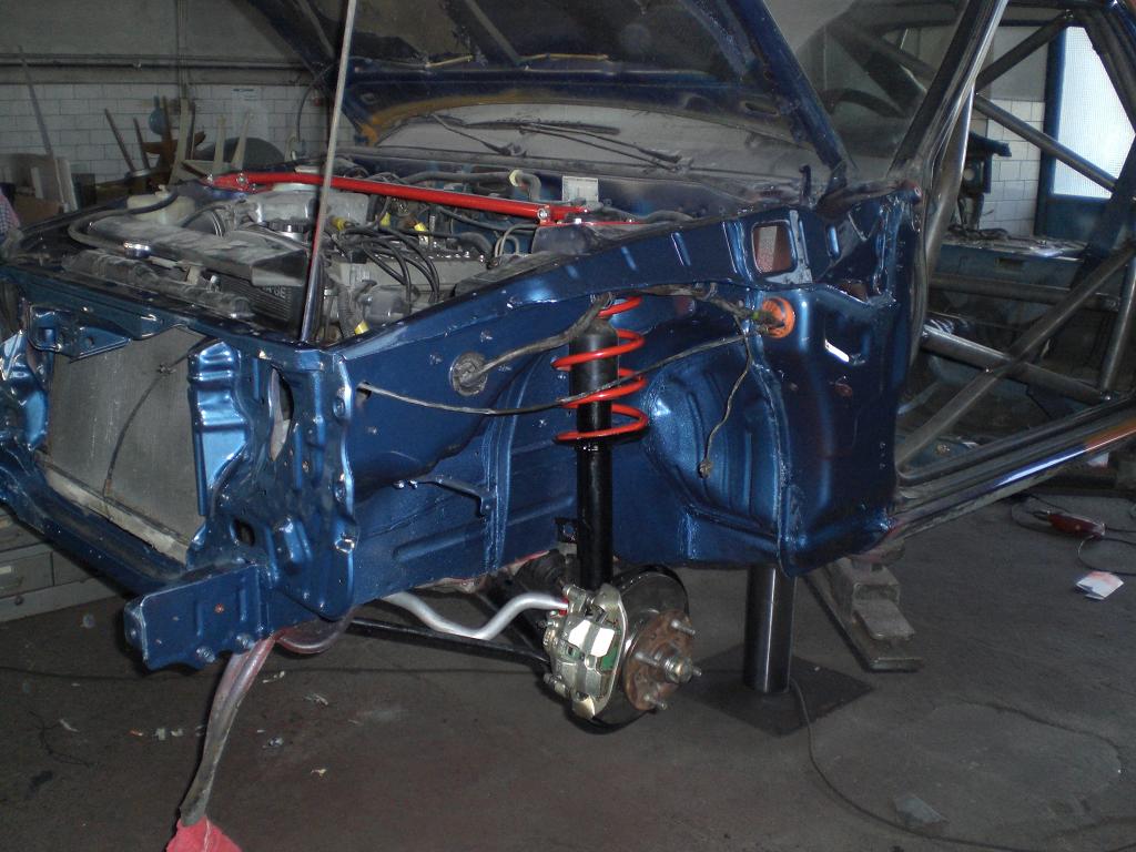

pic. 13,14,15,16,17 time for suspension and break ; mods: new koni shocks and new koni springs, whitline front and rear swaybar,wiechers strutbar, rollcage, polybushes, new brakes front and rear,new e-brakecables, new wheelbearings, ás well as nearly every screw for the suspension ....and so on...... pic. 18, fueltank, with new walbro 255 pump and new fuel sensor pic 19, 20 paint the front: |

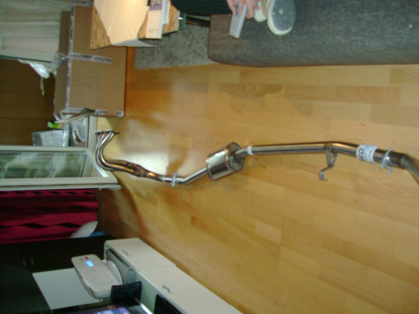

pic 23,24,25,26 some parts i bought, but need to install: Sk Sportsinjection Kit, Janspeed Stainless-steel full exhaust system, goodridge breakhoses, wiechers full roll cage more will follow.... |
