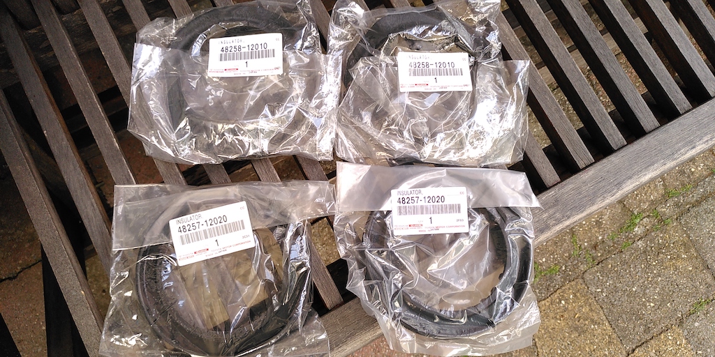

I already ordered new bushings for the links and a set of rubber insulators for the springs as those are shot as well. The bottom insulator I ordered isn't the Carina part number as that's made out of unobtainium. So I ordered an AE86 insulator instead as it looks close enough. It will probably require a bit of fettling before it will fit and in worst case I have to find another alternative and sell the AE86 ones here on the forums.

I do have a ratchet with screwdriver bits and also an impact wrench, but the bits are actually too small to have any leverage on the shock. That's why there are scores on the one in the photo. I was planning on visiting the professional tools shop next week and see if they have bits that are larger. I'll keep the chisel in mind as a last resort. Wink
Insulators are expected to arrive on Tuesday, bushings are still unknown as United Arabs tracking just says they left the country.
Correction: insulators have arrived today! Huh
JP-Carparts sent them from Japan on Wednesday and they already have arrived! Hurray!
