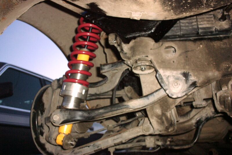

Bad_Dog from Bulgaria
rear coil-overs - made by Jamie + eibach springs

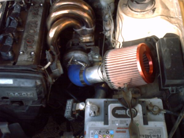

went turbo.
Currently: 1. Stock MAP Bluetop; 2. MS + Stock toyota sensors 3. Toyota Celica Coil On Plug; 4. T25 turbo 5. 0.6-0.7 bar boost; 6. 440cc Supra injectors; 7. K&N filter AE86 GTS '84 Red Top |
